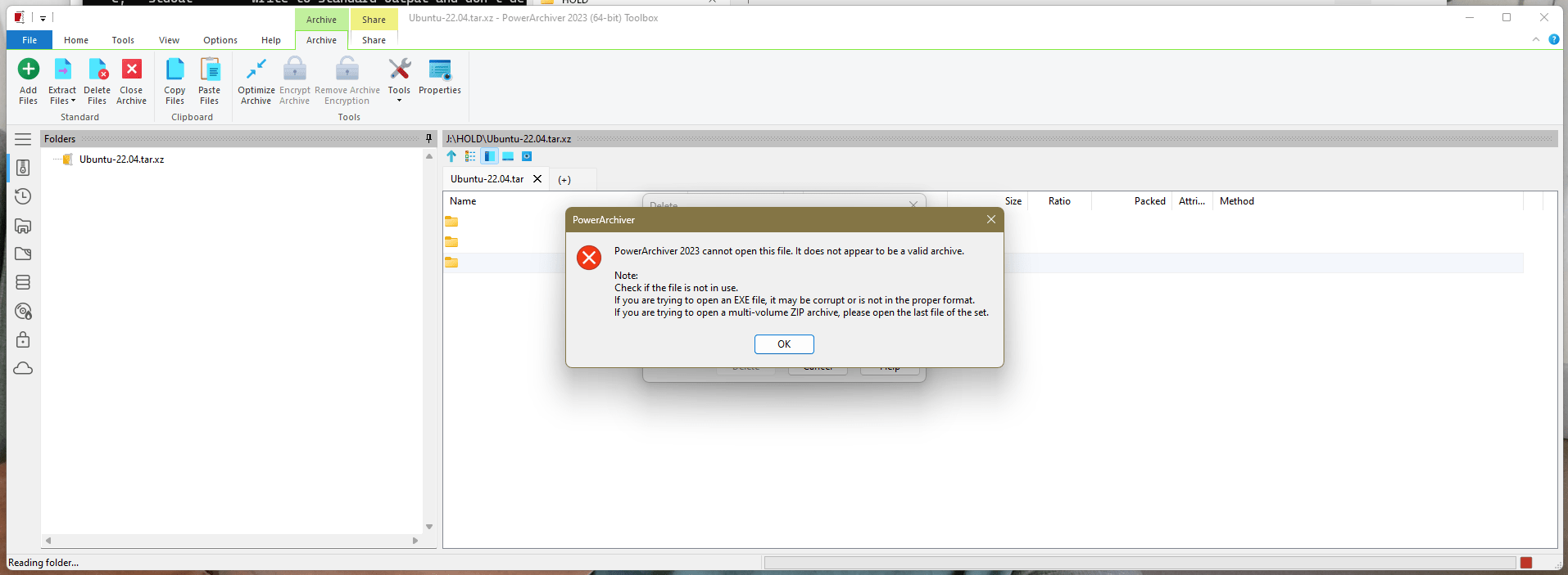

                I tried it again. After attempting to delete a directory in the .tar (or .tar.xz) file I get this:
                and then the file is truncated.
