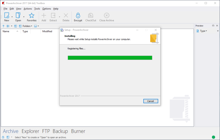

      2017 17.00.40 - Hung during install. It stuck on registering files.
      The icon had appeared on the desktop, so after a few mins I clicked that.
      PA opened ok, but the installer was still hung.
      Windows 10 *64 - Latest TP (Fast)

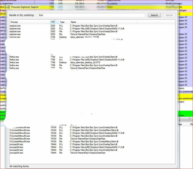

                              This seems to be fixed by renaming the file “C:\Program Files\Box\Box Sync\IconOverlayClient.dll” which is part of BoxSync for Windows available from https://app.box.com/settings/sync
                              I already thought BoxSync for Windows was utter rubbish compared to DropBox or even GoogleDriveSync but unfortunately I have 50GB free for life on Box and don’t really want to pay for an alternative. But it’s still fairly usable without IconOverlayClient.dll.
                              spwolfS PA_FanP 2 Replies Last reply Reply Quote 0
