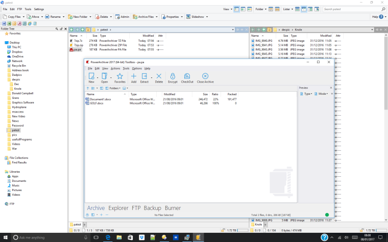

brilliant format
this format compresses word files better than rar zip and 7zip thanks powerarchiver
@davidsplash said in brilliant format:
can you post some examples here? It will be useful for both us and other users. Thank you!
will do over weekend I use word 2003, when I’m on my home pc.
all archives have the same two files in them.
I just wanted to show that pa format compresses better than 7zip on Microsoft word files
Nice! Thanks @davidsplash!!
