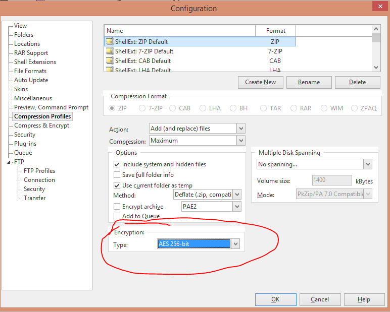

            As for the compress and encrypt option, you can already do that by configuring the ZIP format in config to always compress the file you are creating.
            Here is a screenshot of the configuration screen where you can set the Zip format to always compress. Once you set it, every time you want to make a Zip file, it you will be asked to set the encryption password.
              There is also Compress & Encrypt shell option that can be enabled and then configured in Options as well.
