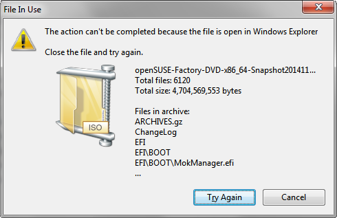

      I have noticed I cannot delete large archives, please see the attached.
      The file is not open in explorer in any operator-instigated way. All affected files are approx 4.5Gb on an NTFS partition. Smaller files can be deleted without issue. Is this related to (I assume) PA showing the archive contents in the delete dialogue box?

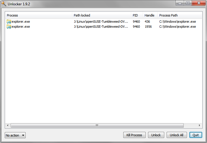

        Currently I have to use an unlocking/deleting facility.

            Yes. I can delete smaller ISO files even from the same location., but this one is approx 4.5GB. It is an OpenSuSE distro ISO.
            The attached is what I see then I try to delete the ISO and a screenshot of an Unlocker screen to show why. PC only turned on 30 mins ago. 100% reproducible.

                          I am doing nothing to these files. I cannot delete any OpenSuSE distros, I have both 13.2 distos and latest snapshots of Tumbleweed…that’s 4 in total; even after just turning on my computer. Done nothing to them at all. All I have to do is download and try to delete. I don’t know whether it is a size issue, but I could delete a Knoppix distro at 4.1 GB.
                          The on thing I have noticed, is that before the first delete attempt, which always fails, there are no locking processes. These show up (as per the above screenshot) only after the first failed attempt.
                          Cheers
