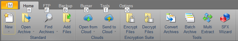

But I don’t have the option you are discussing. See the image.
Perhaps the option is there only if you choose the Win8 Skin?
you have to open archive… then it shows up.
Ah. So every so you are inside the archive, it will make an sfx of the entire archive . . . rather than its contents?
did you check it out? It is exactly the same option as in shell - shell in fact calls this option in main PowerArchiver. So for 7zip, zip, cab, it creates self extracting archive (meaning contents inside archive)
