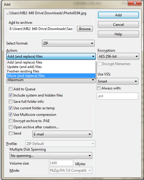

        Mili conexware @Socrates
        @Socrates:
        Now if you can add the move options as well as copy . . .
        Is this the Move option you’re referring to?
        This is the D&D window.

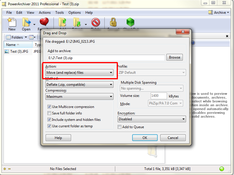

            Here is another screenshot when Drag and Dropping a file inside the main PA window with another archive already open.
            Please note the highlighted MOVE option which moves file inside the archive, which are then deleted off your initial hard drive location.
            Going by what you are describing the is exactly the option you are looking for and it’s already in PA 2011.
            If that is not the option you are referring to, please be more specific as to the option that you are referring to.

                Socrates Banned @Mili
                This gets me part of the way there. But the window has to open.
                And you have to set it to always move and replace, whereas the options in explorer, etc., let you determine by holding down a key when D&D whether it will move or copy.
