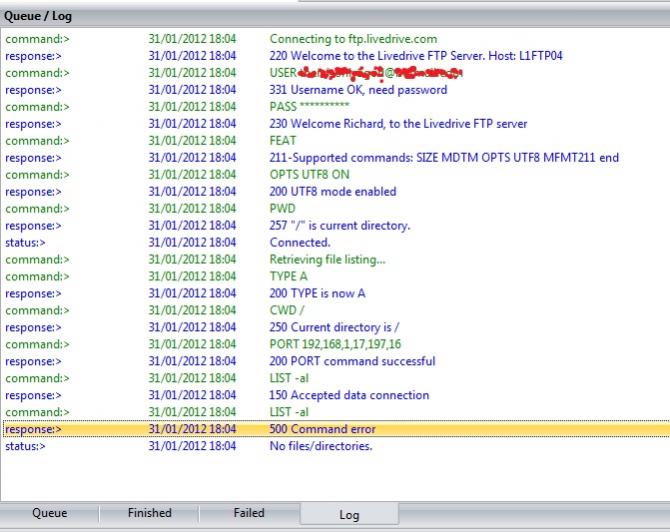

      Ok, just been playing, and had a look at the FTP Log file that Powerarchiver creates! of which really should let me copy and save the Log as text like Filezilla!
      sounds like a nice Feature Request :)
      I will log this one in and see what can be done.
      If we need anything else, will let you know.
      Thanks for taking the time to provide the details!!

            hopefully, i have given you enough data to gain an idea of whats going on.
            Couldnt you contact the software firm who provided you with the FTP Source code and see if they know about anything similar? surely they have people who can help?
              Got it logged in with the log info, lets see if that will help. If not, will let you know further.
              Thanks!!

                Cheers!! so how soon can we expect a patch? i am keen to get this ironed out and use PA. :)
                  Not sure yet, will check though :)
                  I’ve also checked this;
                  2. When the user clears the port number as 0 or nill on save it defaults it to 21 or whatever number relivant to the mode. [ stop this please, if a user has removed it after it being there in the 1st place they wanting to]
                  If you enter zero in the port number field and save it as that, than zero is saved.
                  If you just clear the port number field and leave it blank, it goes back to 21 as that is default, which seems correct, no?

                          patience, you just reported the bug… you should have reported it first time you got it :-)
                            Check this out:
                            www.powerarchiver.com/test/alpha120/powarc121201.exe
                              BOOM! SUCESS! FIXED! RESOLVED!
                              I am now able to connect to my livedrive account as fast as a commerically available ftp client! with no current sign of issues.
                              I obviosly, will be testing this out and let you know if there is a problem but from my 1st impression its back to what it was during alpha development.
                              Thanks team! you made a pro user very happy.
