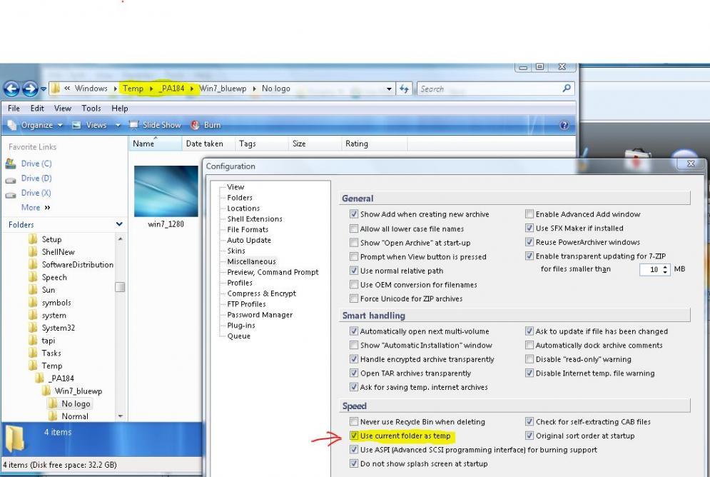

          In PA2010B3 I ran some extract tests and see the same issue.
          Drag and drop from the contents of the archive in the PA window to a Windows Vista 32-bit Explorer window, the extracted files go to the temp folder, and are then copied (Windows Explorer copy function being invoked by PA) to the ultimate destination.
          However, PA only seems to extract what it actually needs and not the entire contents of the archive, unless you select everything.

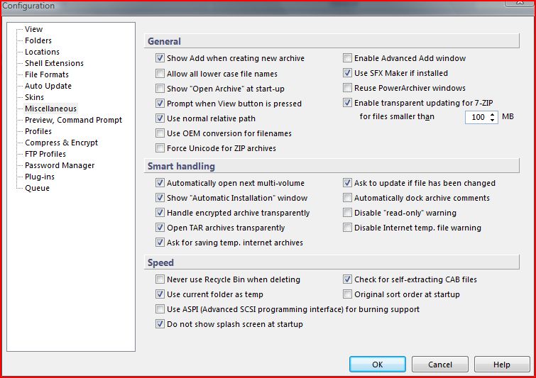

          I tried two scenarios with “use current folder as temp” in the Speed part of Miscellaneous options turned on.
          • from network drive to local drive
          • from one local drive to another local drive (same drive or different drive, makes no difference)
          In all cases the extracted files first go to the temp folder (I am using the default setting), and then a Windows Explorer copy command is executed.

            You can refer to my screenshot from post 7 for the speed and misc settings I have.

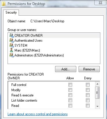

                  Im starting to think its a permission issue. For example, I have been using the dekstop as a test case for extractions. However, the ‘Creator Owner’ account dosent have any permissions set. When I check any boxes (read, write etc) then hit apply, the boxes uncheck themselves.

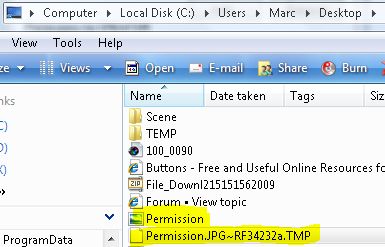

                  Second. Just using the snipping tool to save a JPG to the desktop results in the saved image + a tmp file created on the desktop.
                  I’ve attached 2 screenshots to show the above. Again this may be the problem.
