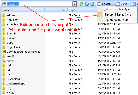

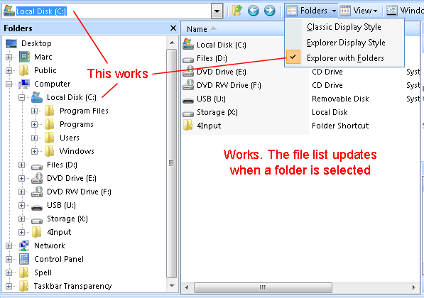

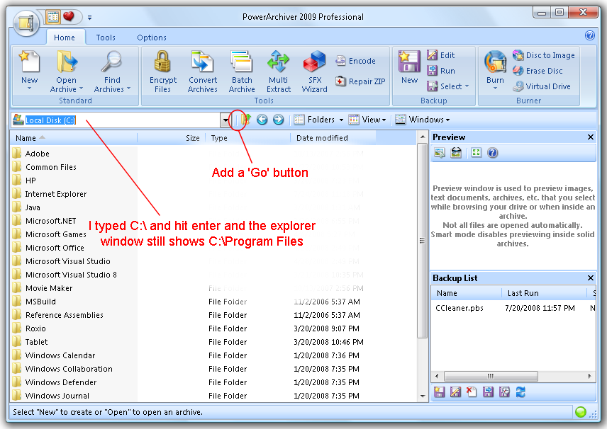

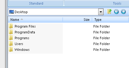

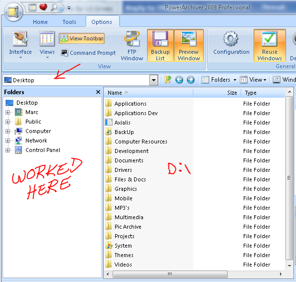

                    My 2 screenshots in post 7 describe the problem pretty good. If the folder treeview is visible with the files pane then what happens is the folder tree updates as it should. But the files pane still shows the contents of the previous folder.
                    If you have the folder tree off (which I do) then the files pane simply will never update no matter what location you type into the address bar and hit enter.
                    Really though in both instances, the files pane does not update. 1st screenshot shows with folder tree and second one shows without folder tree. So in the second one when the folder tree is off, there is no way to update the files pane by typing a new location. Type hit enter, nothing happens.

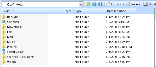

                        I can make a movie (after installing some freeware app) but all it will show is a PA window with the file pane visible. Then the text C:\Windows being typed into the address bar followed by the enter key (which wont show). The files pane will not update and display the contents of C:\Windows.

                                  Otherwise type+enter does nothing. The only other info I can add is settings.

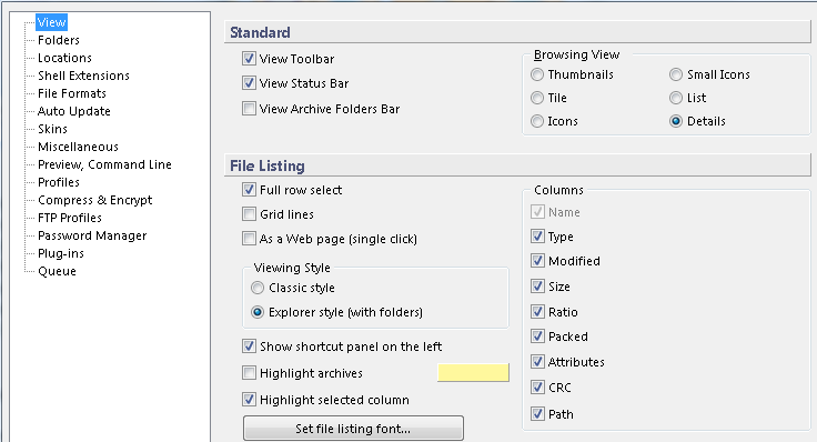

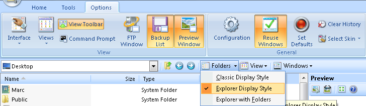

                                  I do see one discrepency here. From the UI on the toolbar, under Folders I have “Explorer Display Style” NOT Explorer with Folders. But in the Preferences, View section it says: Viewing Style = Explorer style (with folders).
                                  Could it be as simple as a conflict of settings? See attached.
