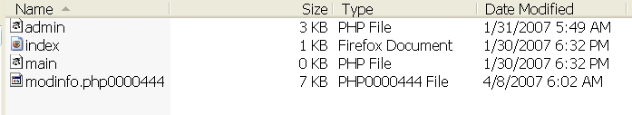

      I have a .tar.gz from a CPanel full backup, and there are quite a number of files within the archive, that Powerarchiver “reports” as having a different filename extension.
      The problem is not with Cpanel, or with the actual archive, because my web host provider has been able to extract the full contents of the archive, and all the filename extensions are okay.
      Powerarchiver is listing the files as having different filename extensions, and therefore when I extract the archive locally, there are many files (337 out of 4,373 files) with invalid extensions.
      The extensions are changed as follows:
      .GIF –-> .GIF0000444
      .HTML —> .HTML0000444
      .php ----> .php0000444
      I’m using version 10.01.03, but actually I have noticed this problem with earlier versions, however as it was only a few files, I simply renamed them.
      It appears the bug in Powerarchiver is somehow referencing the filename permissions (444) and appending it to the filename extension.

          • P Offline
            peterr @TBGBe
            Thanks for that link. It sure does look like a very similar problem. :(
            When I extracted the tar.gz locally, PA even created this folder
            \public_html***\thumbs\0000755\
            and there is definitely no such filename on the website, I just checked. The permissions on the path “thumbs” is 755 though, so the bug seems ‘constant’ to some degree, appending the file permissions, but seems to be doing it quite randomly (which I guess contradicts what I said about being ‘constant’).
            I used both PA and 7-Zip to extract the archive, then used beyond compare to do a binary comparision of all the files, 4006 match and 341 are different, having filename extensions as explained in the first post.
            The file sizes and timestamps are exact though, in the Beyond compare display, it’s just the file extensions that are messed up.
            Bit of a problem alright.

                • P Offline
                  peterr @TBGBe
                  @TBGBe:
                  Can you try creating the backup with PA (tar.gz) as a test to see if the problem still occurs?
                  Yes, I created a tar.gz with PA on all the archive files, and I used the ‘correct’ files, that is, those with correct filename extensions.
                  PA has even messed that up, lots of weird filename extensions like:
                  H0000002
                  HT0000002
                  HTM0000002
                  HTML0000002
                  HTML444
                  P0000002
                  PH0000002
                  PHP0000002
                  PHP00444
                  PHP0100444
                  etc,etc
                  I also used the same files to create an archive with a ZIP and a 7Z extension, and there are no strange filename extensions. Seems it is only happening with .TAR.GZ files, and yet a Linux ‘tar’ program plus the (freeware) 7-Zip software were both able to view the contents correctly, …. but not PA. :(
                  P 1 Reply Last reply Reply Quote 0

                      • P Offline
                        peterr @peterr
                        This is getting ridiculous, I just created an archive (.tar.gz) with 2 files in it, and both have weird filename extensions.
                        Both these files had long filenames; does PA have any problems in that area ? This thread - http://www.powerarchiver.com/forums/showthread.php?t=1302&highlight=long+filename seems similar.
                        Looks like I use “7-Zip” until this is sorted out. :(

                                    • P Offline
                                      peterr @spwolf
                                      Having tried a few different things, decided to set the config. to ‘default’.
                                      Tried the compression again, and the filename extensions are okay, but the pathname is not correct for uploading to the website.
                                      I always need to have the option “use normal relative path” checked, to make the pathname ‘valid’ for uploading.
                                      So, is this a ‘clue’ to the problem ?
                                      Under PA settings:
                                      -Config
                                      –-misc
                                      ------use normal relative path
                                      • When checked, file extensions are messed up
                                      • When unchecked they are okay, but the pathname is not ‘suitable’.
                                      I can re-arrange folders locally so that the correct pathname is included as the first one (highest), …BUT I think the only way I can get ‘empty paths’ into an archive is to have this option set on (checked). :(
                                      This is only a small test, with those 2 files, but they are part of a substantial (path) heirarchy.
                                      Just tested a considerable number of files (3250) with the option “use normal relative path” unchecked, and all the filename extensions are okay. Now I can see the full pathname/filename for one of these is 91 chars. If I include the “full” source pathname/filename, it is 149 chars.
                                      Have now used the same files to create an archive, with the option “use normal relative path” checked, and the filename extensions are messed up. Even with the additional pathname added, it is still only 103 chars
                                      So, could that option be the cause of the ‘bug’ ??
