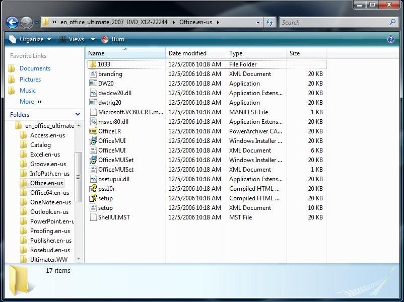

      When extracting ISO files, all files extracted are capped at exactly 20kb. The file and directory structure is intact.

              suckamucka
              Here are some screenshots.
