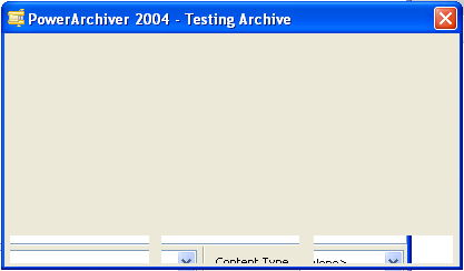

            Here are a couple of images to help illustrate what I’m trying to convey:
            This image illustrates what I see for a few seconds after selecting a large archive to be tested by PA. I would like to see the window painted as soon as the archive is opened, instead after the Central Directory has been read.
            D 1 Reply Last reply Reply Quote 0

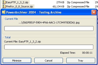

            • D
              deipotent @deipotent
              This image illustrates my second point. This image was taken after the EasyFTP_1_3_2.zip archive had been tested, but before the testing of Firefox_0_8_Source.zip archive had actually begun (ie. whiole the Central Directory of Firefox_0_8_Source.zip was being read by PA).
              I would like to see the “…{56DFB5…}.jpg” text changed to “Reading file structure…” (or something like that) to indicate what PA is actually doing. Also, the text “Current File: EasyFTP_1_3_2.zip” should be updated as well to “Current File: Firefox_0_8_Source.zip” to indicate that this is the archive that PA is currently being tested.
